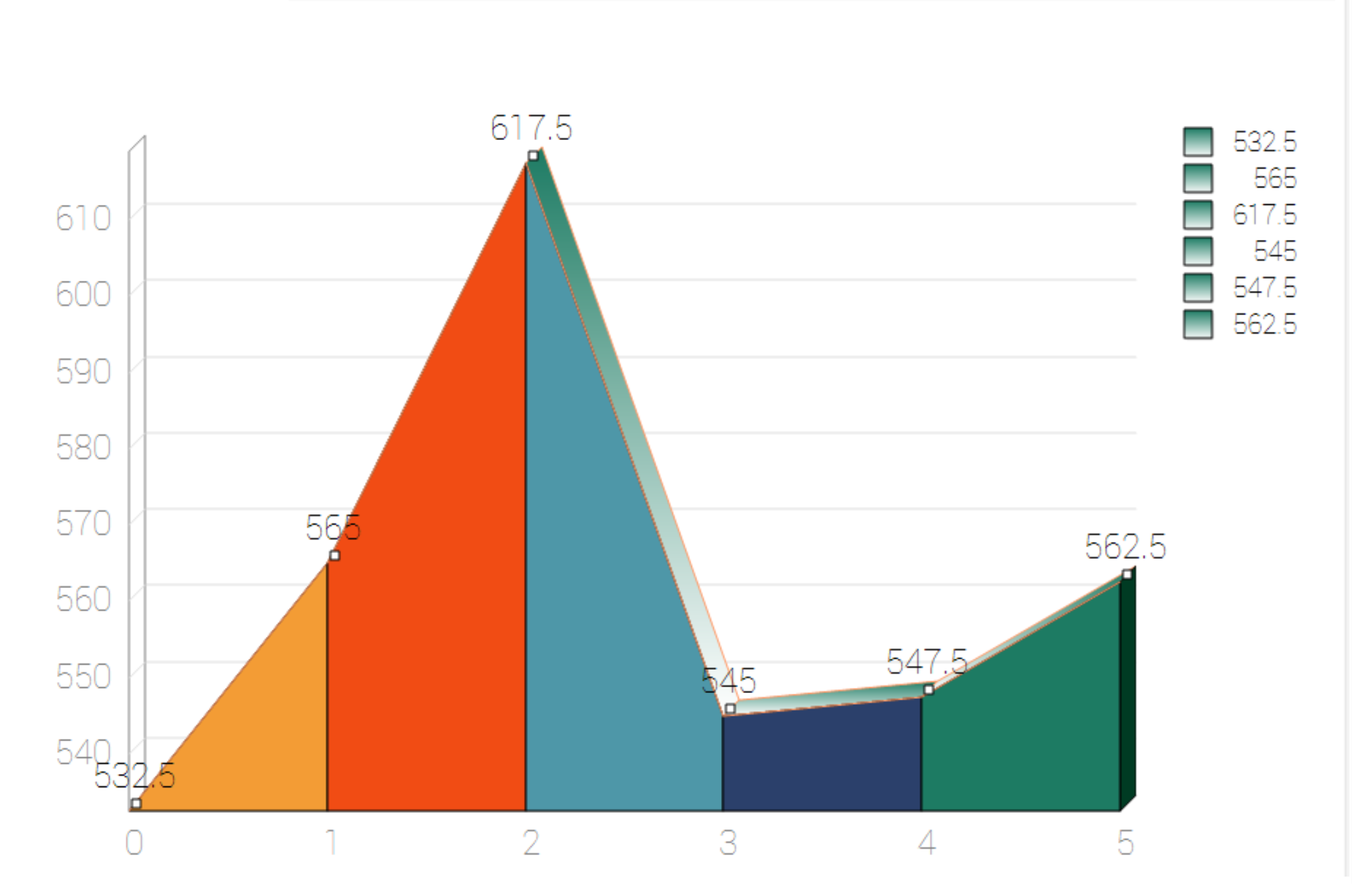

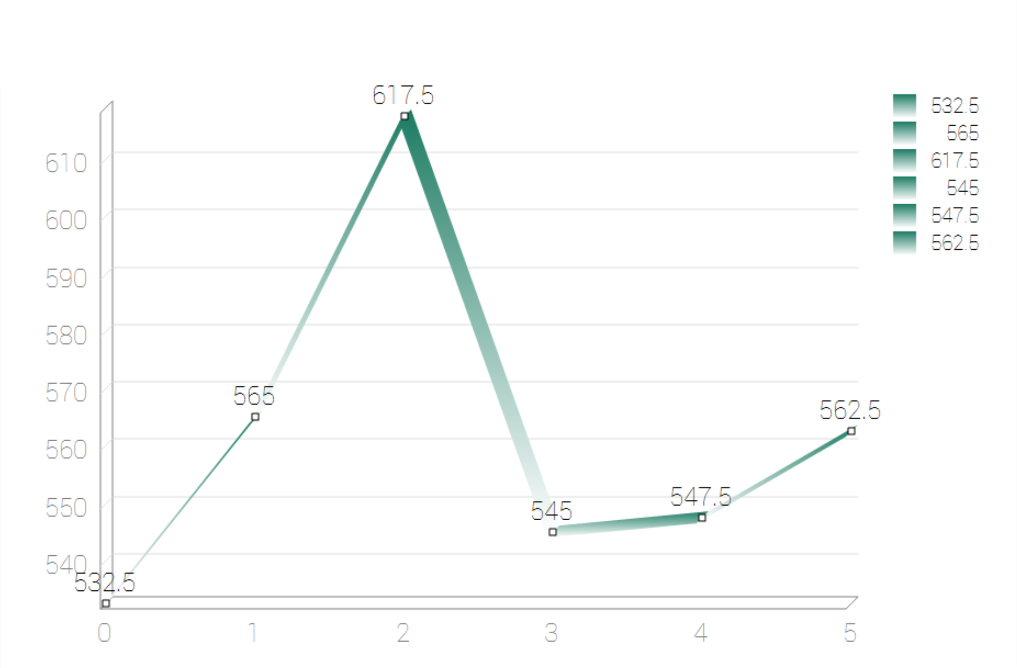

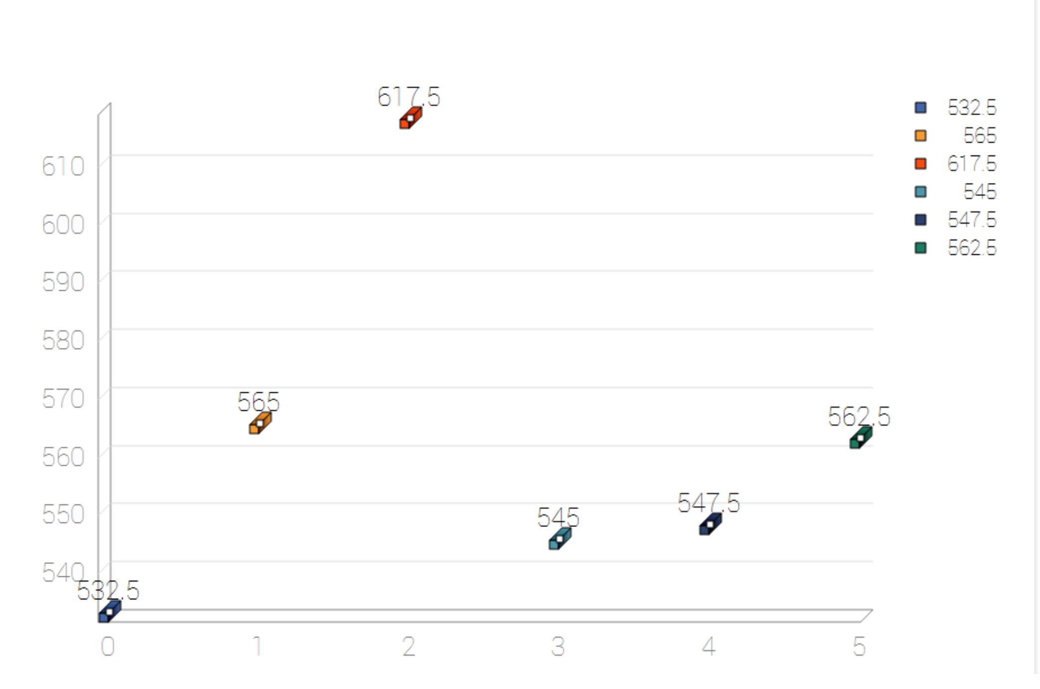

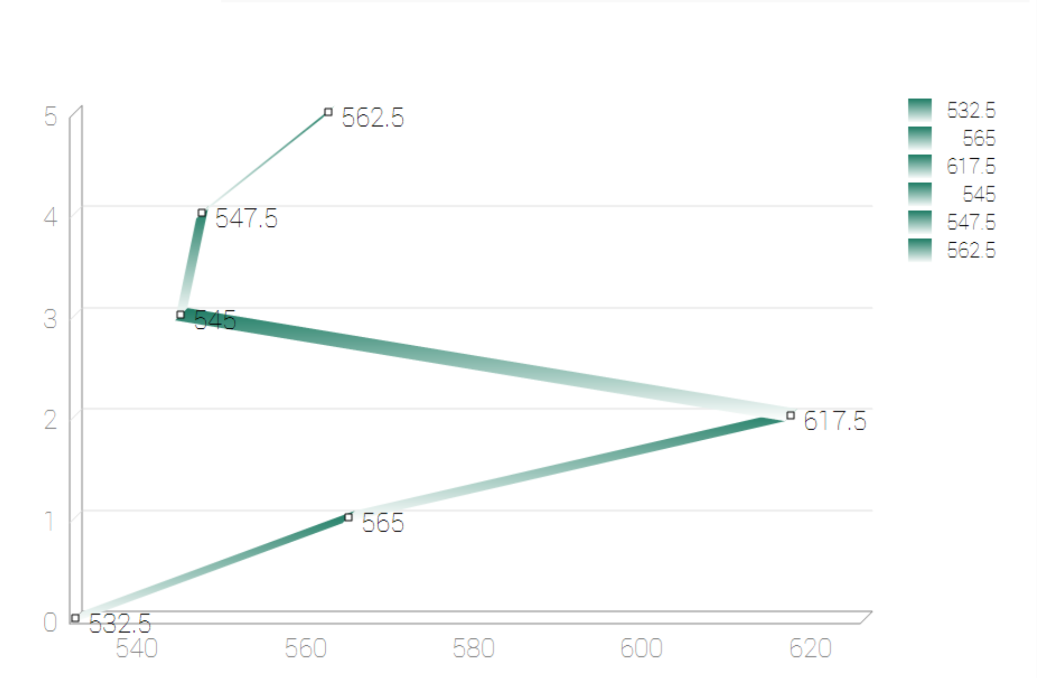

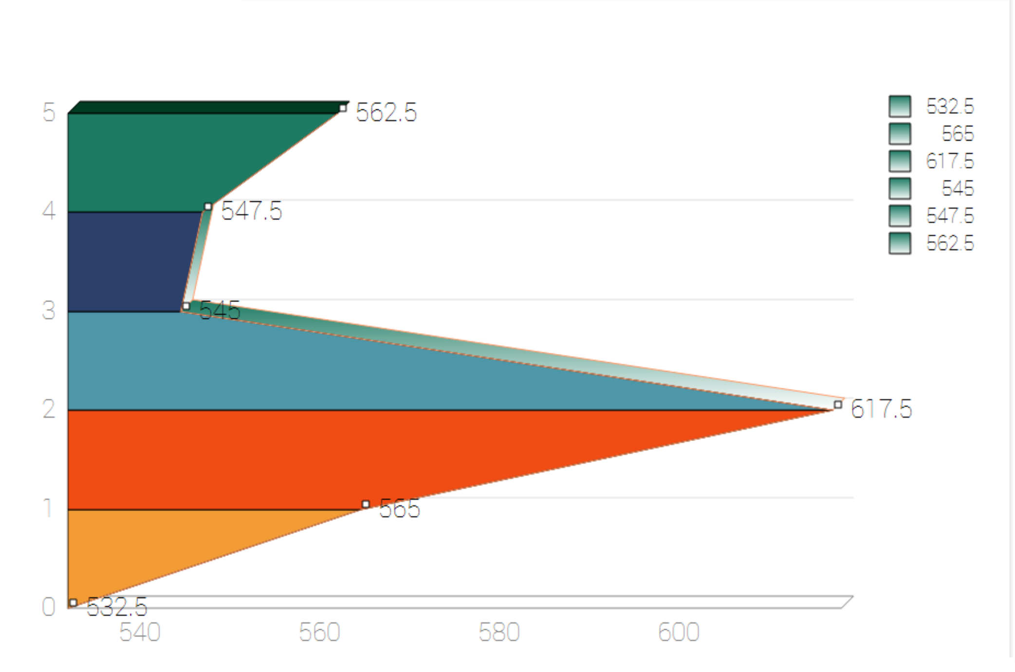

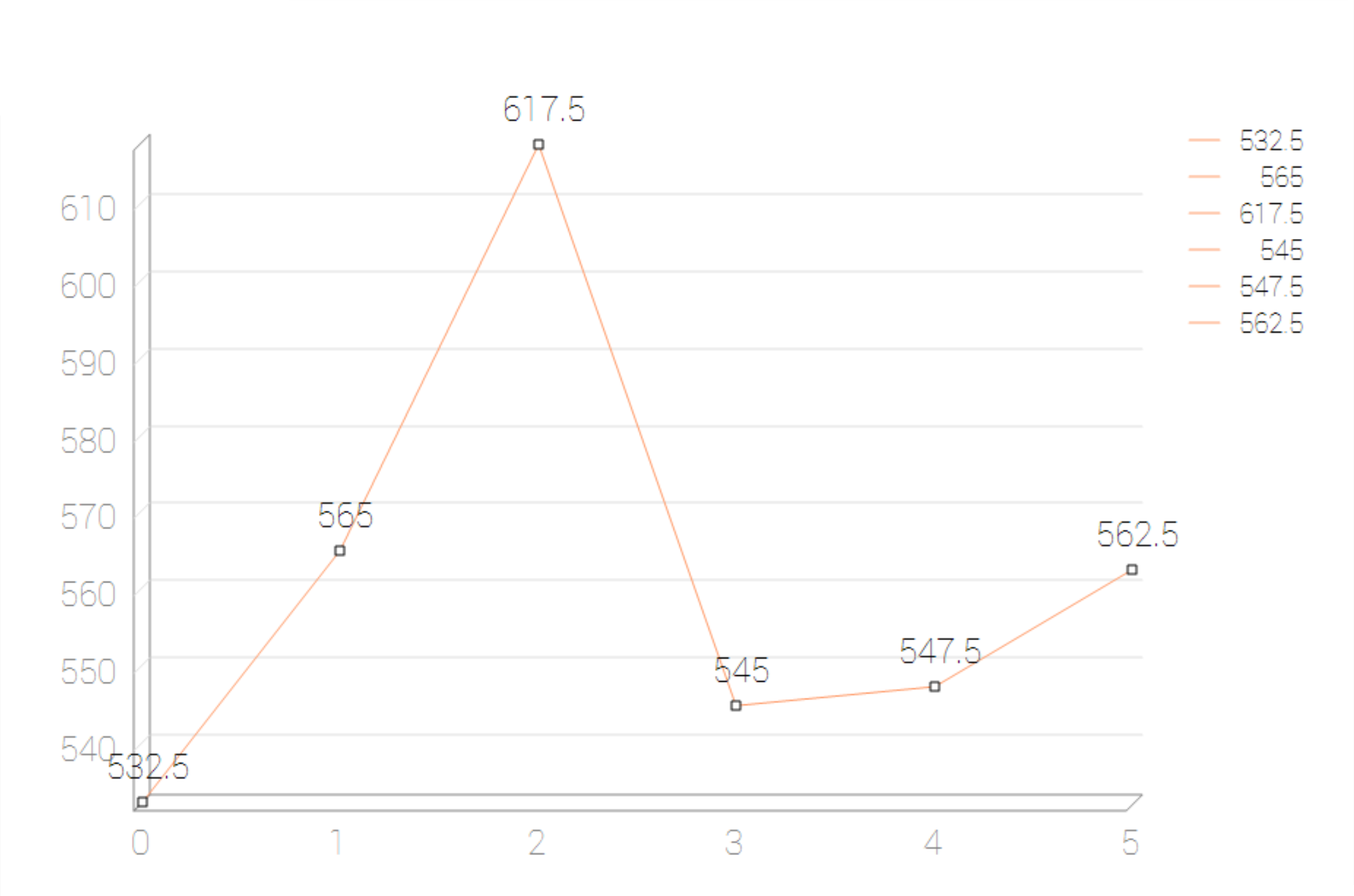

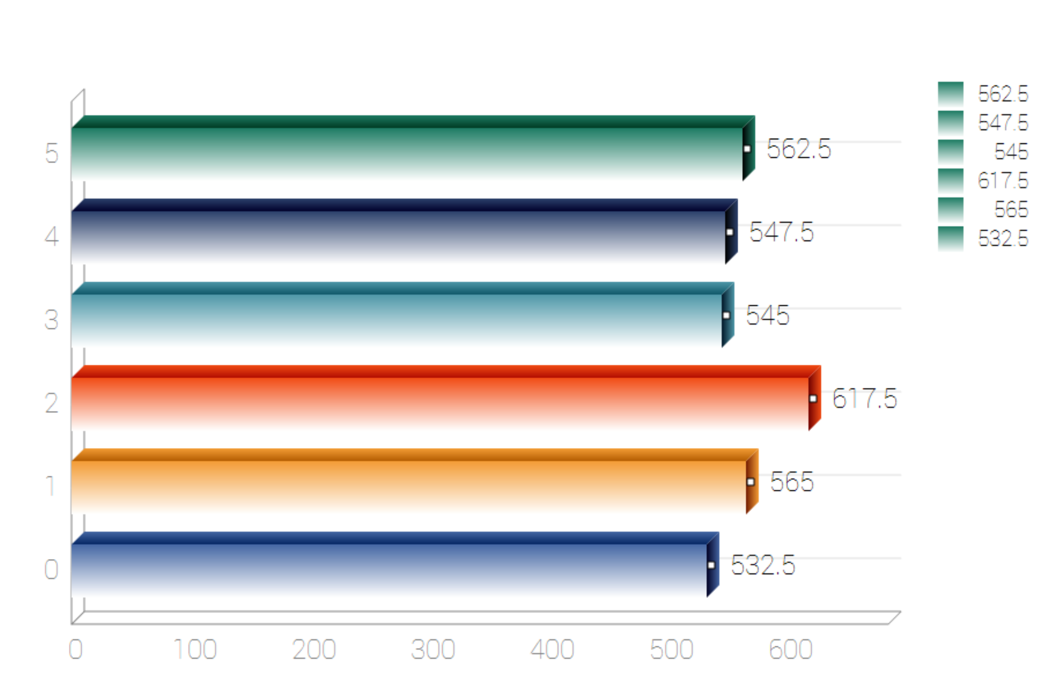

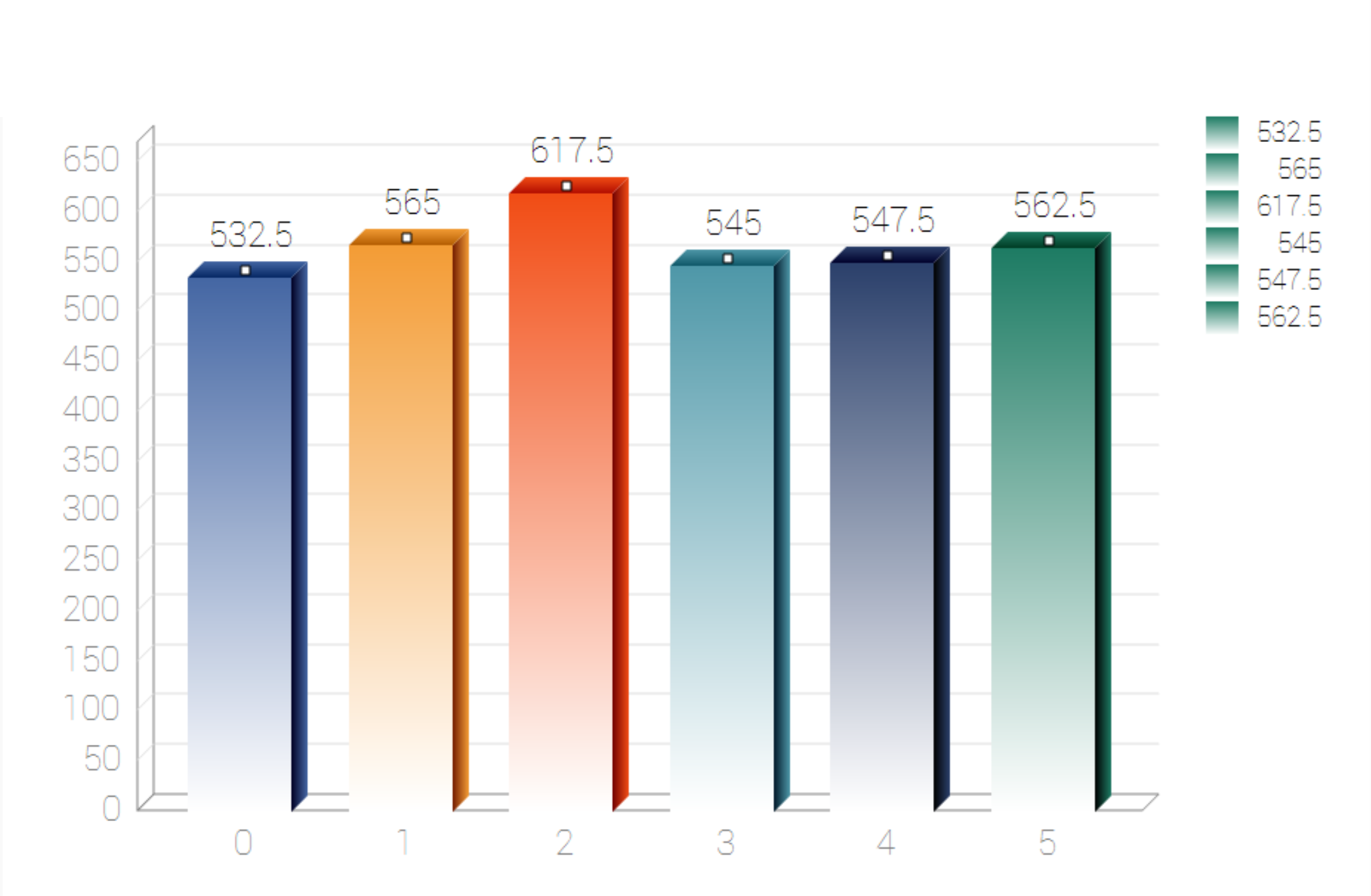

You can create different kinds of charts: Pie, Line, Horizontal Line, Fast Line, Bar, Horizontal Bar, Area, Horizontal Area, Point.
  • pie Pie
  • line Line
  • hor line Horizontal Line
  • fast line Fast Line
  • bar Bar
  • hor bar Horizontal Bar
  • area Area
  • hor area Horizontal Area
  • point Point
Creating charts in NodeActa system is simple. You can use ChartView control shipped with the system. Example how to create a chart can be found in Samples→Chart Sample app.
ChartView control is also a nice example how to create a custom control using C++, Delphi or any other environment that can produce a .dll. ChartView is located at UI→UI Controls→Chart View and is actually just a wrapper around nodeacta.charts.dll. Also notice that CharView contains 2 dlls, nodeacta.charts.x86.dll and nodeacta.charts.x64.dll. This approach allows you to use the same control for 32bit and 64bit platforms.
