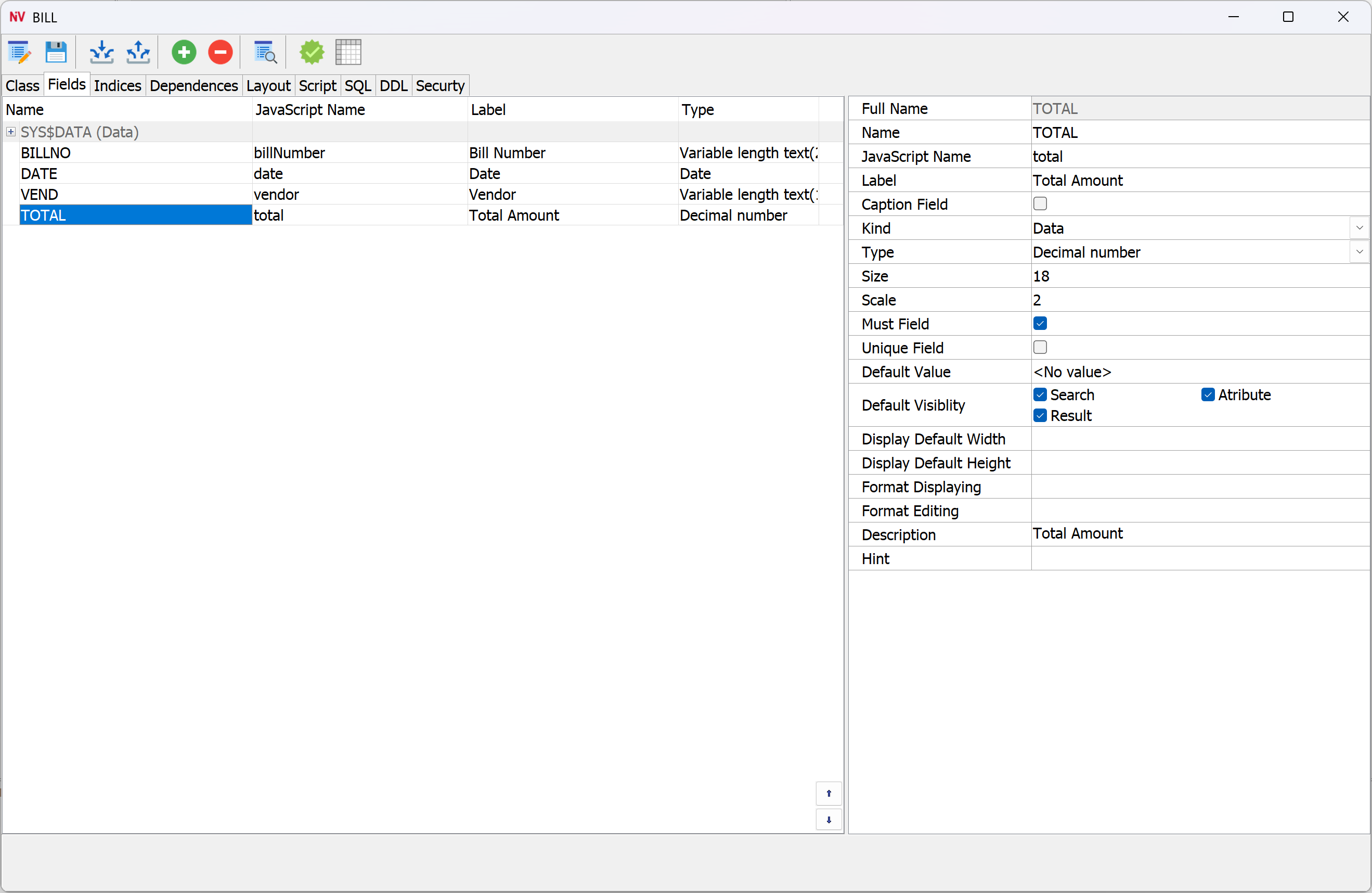

Class Fields
Class fields are the individual columns in a database table that define the structure of the data being stored. Each field represents a specific attribute of the data class and holds a particular type of data, such as text, numbers, dates, or boolean values.
For each feld you must configure the following properties:
- Name: This is the name system uses to identify the field. Also, this is the name of a column in database table, so please keep it short.
- Javascript Name: This is the name this field will be accessed by in javascript. For example
invoice.myField. - Label: Used to represent the field in UI (RecordsView, AtributesView). Field's label can be localized with Localization app.
- Kind (Data, Lookup, Fixed Lookup, Autogenerated, Calculated)
- Type (Yes/No, Whole Number, Decimal, Currency, Floating-point Number, Date, Time, Date and Time, Fixed-length Text, Variable-length Text, Memo, Rich Text, Image, Binary)
- Size and Scale for the types that require it
Optional field properties:
- Caption field: At least one field must be designated as a caption field. All fields with the 'Caption field' option enabled will be combined to form a record's display label in the generic UI. In certain UI controls where selecting specific class fields for display is not possible, these 'Caption fields' will be used.
- Must field: Fields marked with the Must field option must have a value before calling
record.save(). In JavaScript, this option can be accessed throughMyClass.myField.isOptional. Naturally,isOptionalrepresents the negation of the Must field option. - Unique field: Fields marked as unique indicate that this class cannot contain multiple records with the same value for that field. Attempting to store such a record will raise an exception.
Default value: The initial value assigned to this field when a new instance of this class is created. For instance, if you declare
var invoice = new Invoice(), all properties corresponding to fields with predefined default values will be automatically initialized. !!! hint For Date, Time, and DateTime field types, you can setNOWas the default value, which will assign the current date and time when the object instance is created. -
Default Visibility: This setting determines whether the field will appear in RecordsView, AttributesView, and QueryParametersView, even without configuring the control's layout. The possible values are: Result, Attribute, and Search, corresponding to the RecordsView, AttributesView, and QueryParametersView controls, respectively.
- Default Display Width: The width matching column in RecordsView will have by default (if RecordsView layout is not defined). Can be in pixels, in chars or in procentage. For Example: '100' => meaning 100 pixels, '20ch' => meaning 20 character width, '20%' => meaning 20% of entire RecordsView control width.
- Default Display Height: The height matching row in AtributesView will have by default (if AtributesView layout is not defined). Can be in pixels, in chars or in procentage. For Example: 25 or '4ch' or '20%'.
- Format Displaying: If you require a customized display of the field value in the UI, you can specify the appropriate format. For example, using 'YYYY-MM-DD' for a date field would present the date as '2024-03-19'. More about defining formats you can find here.
- Format Editing: If you require custom formatting when editing the field value in the UI, you can define the desired format. For example, using 'YYYY-MM-DD' for a date field will force you to enter the date as '2024-03-19'. More about defining formats you can find here.
- Hint: Description of the field that will appear as a tooltip when the mouse hovers over it in the AttributesView.

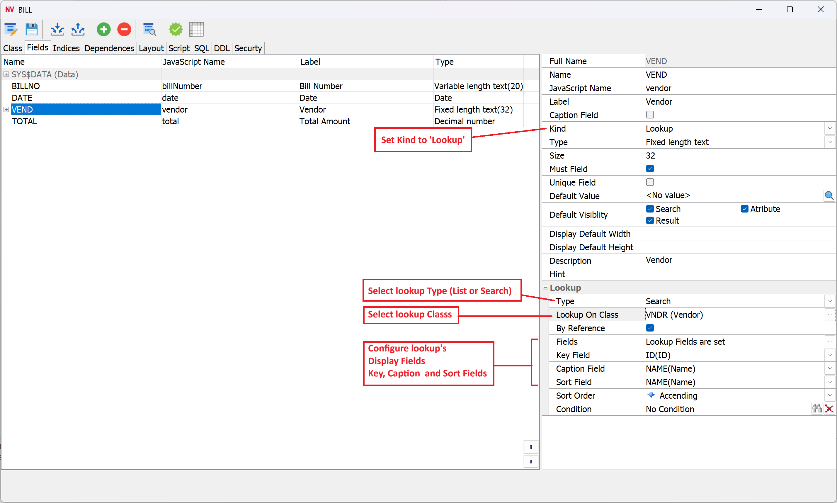

Lookup Fields
Lookups are a type of field that allows you to link (lookup) another document class to this class. Typically, this class will store only the key value from the lookup class (you can choose any field to act as the key field for the lookup). Additionally, you can define one or more display fields for the lookup, which will be automatically evaluated and populated without requiring an additional server request.
For example, the customer lookup has two display fields: Name and Address:
var invoice = new Invoice();
invoice.customer => will be a lookup object of type Customer and this will trigger
a server request to retrieve Customer record.
invoice.customerName => will be a lookup display field and it will not call the server.
invoice.customerAddress => will be a lookup display field and it will not call the server.
Lookup properites:
Type: You can have 2 different lookup types, Search and List.
- List lookup will be displayed in UI with combobox filled with possible lookup values. List lookup should be used only when the number of possible lookup values is small (few dozens).
Search lookup will be displayed in UI with additional search button that will show Search Mask on click.
Serach mask shown for selecting search lookup value is actually lookup data class's Search App (see Class Properties).
Master: Special type of lookup is used to define Master-Slave relation with 2 data classes. If you specify a field to have master lookup type, this will turn this data class into a slave (detail) data class to selected lookup class (Selected Lookup class will be your 'master' in master-slave relationship).
Lookup Class: Data class that is the source of lookup.
- By Reference: By default lookups are 'by reference'. This means that in this class only lookup class's key field value is storred. If you uncheck By Reference option, than all lookup Fields will have its own field in this class (lookup class values will be coppied).
- Fields: Selected lookup class fields that will be displayed in this class.
- Key Field: Mandatory lookup class field that is used to uniquely identify the record from that lookup class.
- Caption Field: Main lookup field that will be displayed in lookup combobox in UI (if List lookup).
- Sort Field: This field will be used to sort lookup values in combobox in UI (if List lookup). If this is Search lookup, this field will be used to sort rearch result.
- Condition: You can filter the available lookup values based on this condition. Additionally, you can use values from the current record, making the lookup dependent on other record fields.

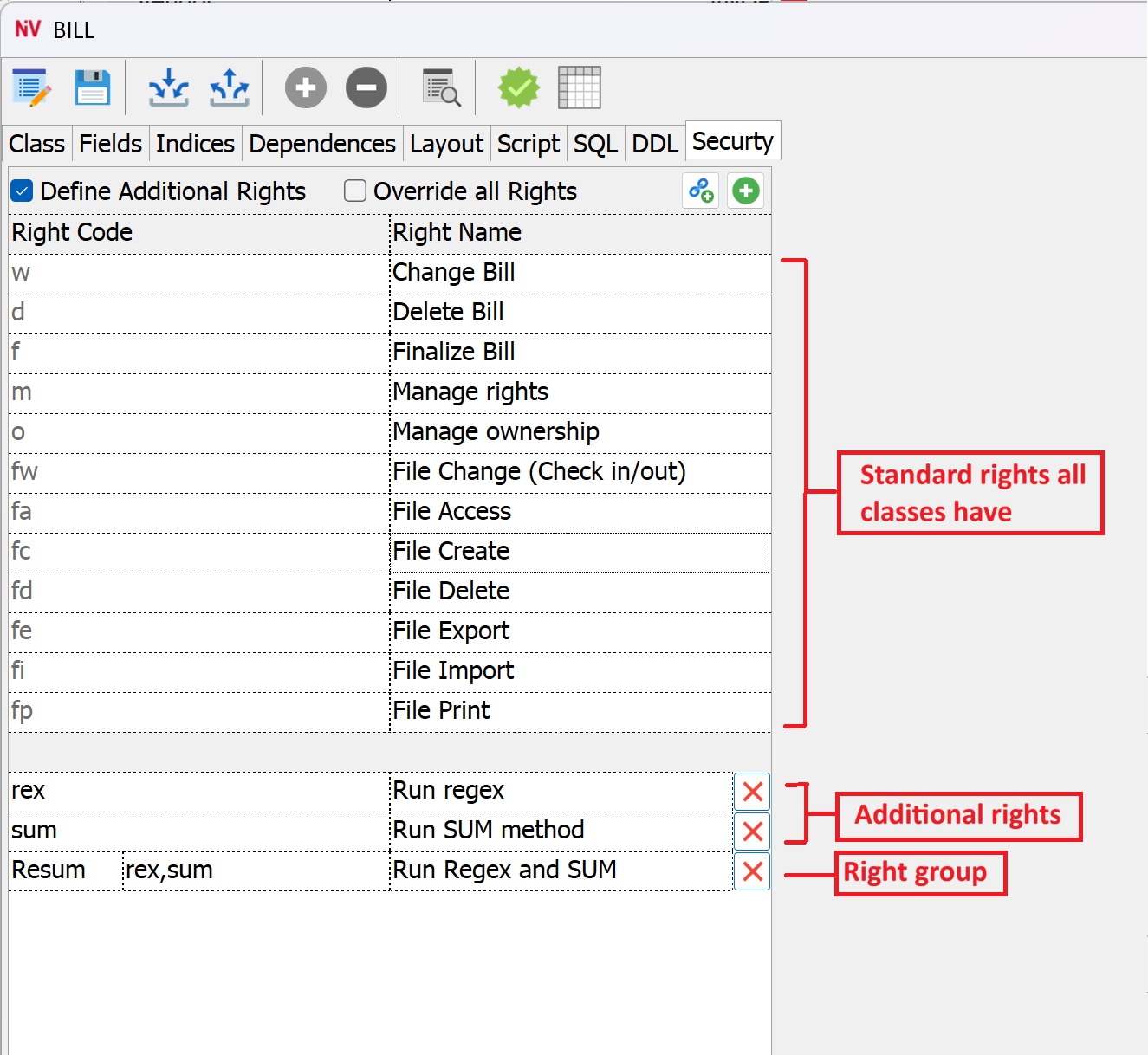

Security
On each data class, you have the posibility to override existing class righs or even define new ones. In javascript code you can check if right is granted with record.checkRight(<right code>). You can also define additional rights or override existing ones (you will be able to rename the rights, but will not be able to change right codes).
