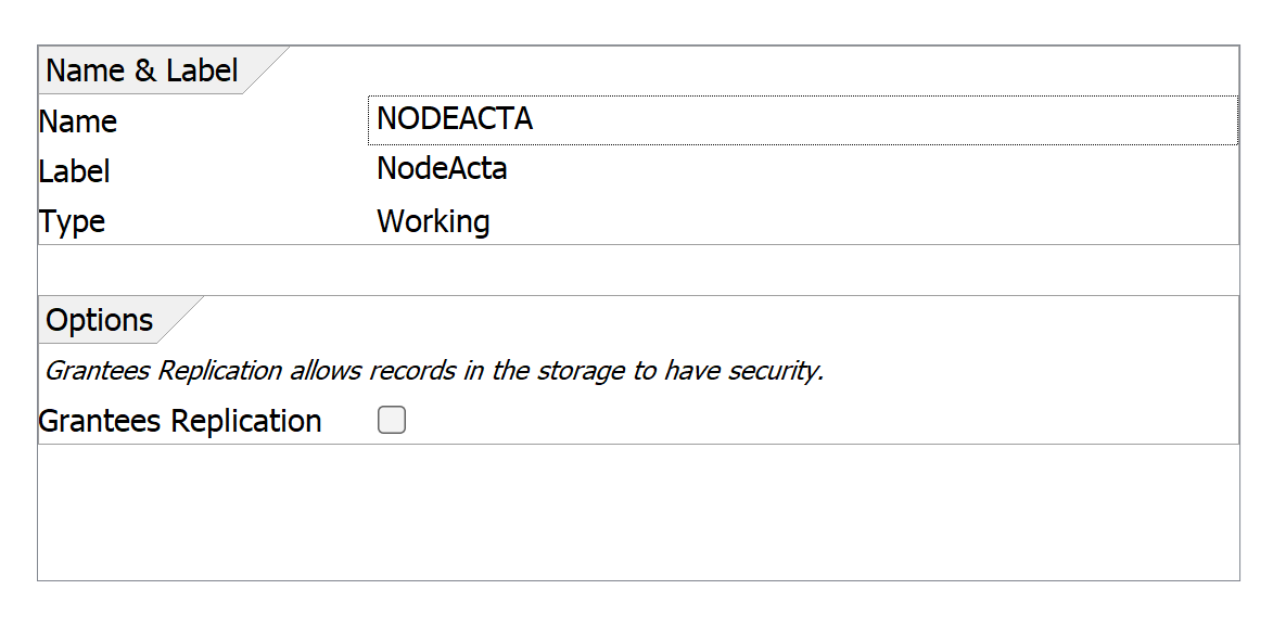

Complex AttributesView
var myName = 'NODEACTA';
var myLabel = 'NodeActa';
var myType = 'W';
var myReplication = false;
this.attributesView = new AttributesView(myPage);
this.attributesView.options.labelsWidth = '15ch';
this.attributesView.source = [
    new AttributePanel( { caption: 'Name & Label' }, [
        new Attribute( {
            label: L`Name`,
            value: (atr)=> myName,
            setValue: (atr, val)=> myName = val } ),
        new Attribute( {
            label: L`Label`,
            value: (atr)=> myLabel,
            setValue: (atr, val)=> myLabel = val } ),
        new Attribute( {
            label: L`Type`,
            value: (atr)=> myType,
            setValue: (atr, val)=> myType = val,
            values: [
                new AttributeValue('W', 'Working'),
                new AttributeValue('A', 'Archive'),
                new AttributeValue('B', 'Backup')
    new AttributeSpace(),
    new AttributePanel( { caption : L`Options` }, [
        new AttributeText( {
            label: L`Grantees Replication allows records in the storage to have security.`,
            font: { size: 8, style: { italic: true } } } ),
        new Attribute( {
            label: L`Grantees Replication`,
            type: AttributeValueType.Boolean,
            value: (atr)=> myReplication,
            setValue: (atr, val)=> myReplication = val } )
attributesview-sample1

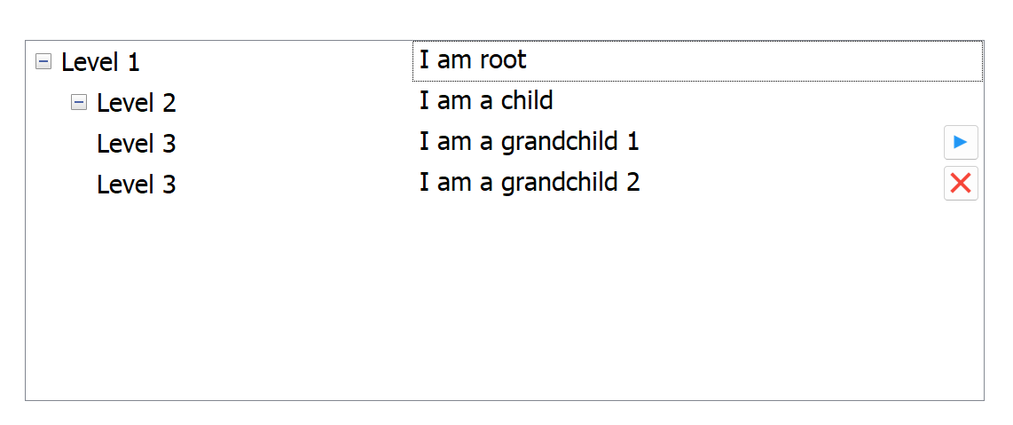

Tree AttributesView
AttributesView can also display a tree like structure.
this.attributesView.options.buttonsAlwaysVisible = true; // commands buttons are always visible
                                                         // not just on focus
    new Attribute( {
        label: 'Level 1',
        value: 'I am root',
        expanded: true,
        subattributes: [
            new Attribute( {
                label: 'Level 2',
                value: 'I am a child',
                expanded: true,
                subattributes: [
                    new Attribute( {
                        label: 'Level 3',
                        value: 'I am a grandchild 1',
                        commands: [
                            { label: 'command 1', icon: Icons.play, command: (a)=> alert(a.value) }
                    new Attribute( {
                        label: 'Level 3',
                        value: 'I am a grandchild 2',
                        commands: [
                            { label: 'command 12', icon: Icons.delete, command: (a)=> alert(a.value) }
attributesview-tree-sample1

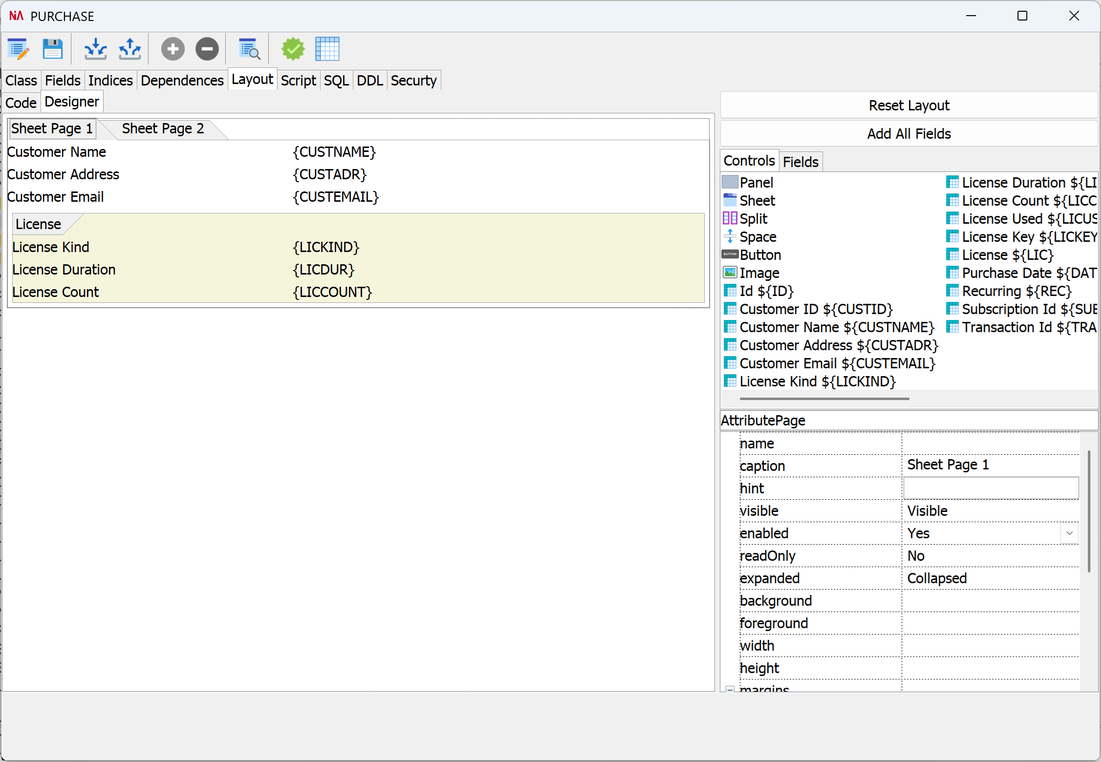

Default Data Class Layout
As mentined above, if you just initialize AttributeView.source property only with a record and you don't set fields and layout, AttributeView will use record's data class layout (if defined). Default layout for a data class can be designed using class designer like in the picture below. You can write layout code directly in code editor, or use the designer.
dataclassdesigner-layout
Please do not confuse this designer with the page layout designer. Both designers have similar available controls, but they are not the same.
