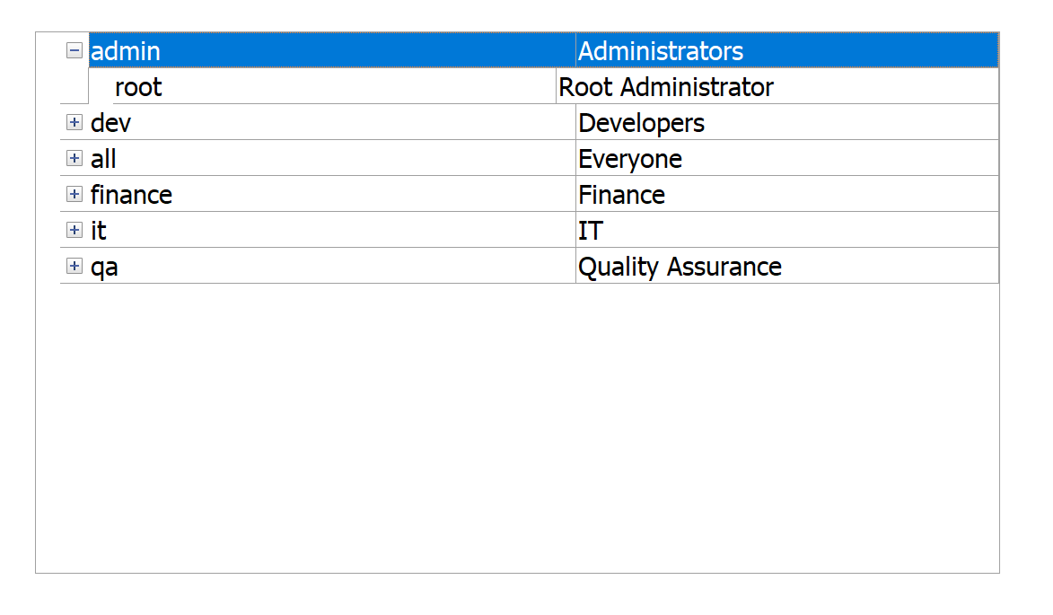

Sub-Records Callback Example 1
this.customersView.subrecords( async (r, idx)=> {
    return await Contacts.where(Contacts.partyB, WhereOperator.Equal, r.id).selectAsync();
var groups = Grantee.where(Grantee.type, WhereOperator.Equal, 2/*group*/).select();
// this is equivalent to Management.groups
this.recordsView = new RecordsView(this);
this.recordsView.align = Align.Client;
this.recordsView.options.gridLines = true;
this.recordsView.options.header = false;
this.recordsView.fields = [
    Grantee.name, Grantee.label,   // 1st level
    [Grantee.name, Grantee.label]  // 2nd level
this.recordsView.subrecords((group)=> group.members);
this.recordsView.source = groups;
attributesview-sample1
