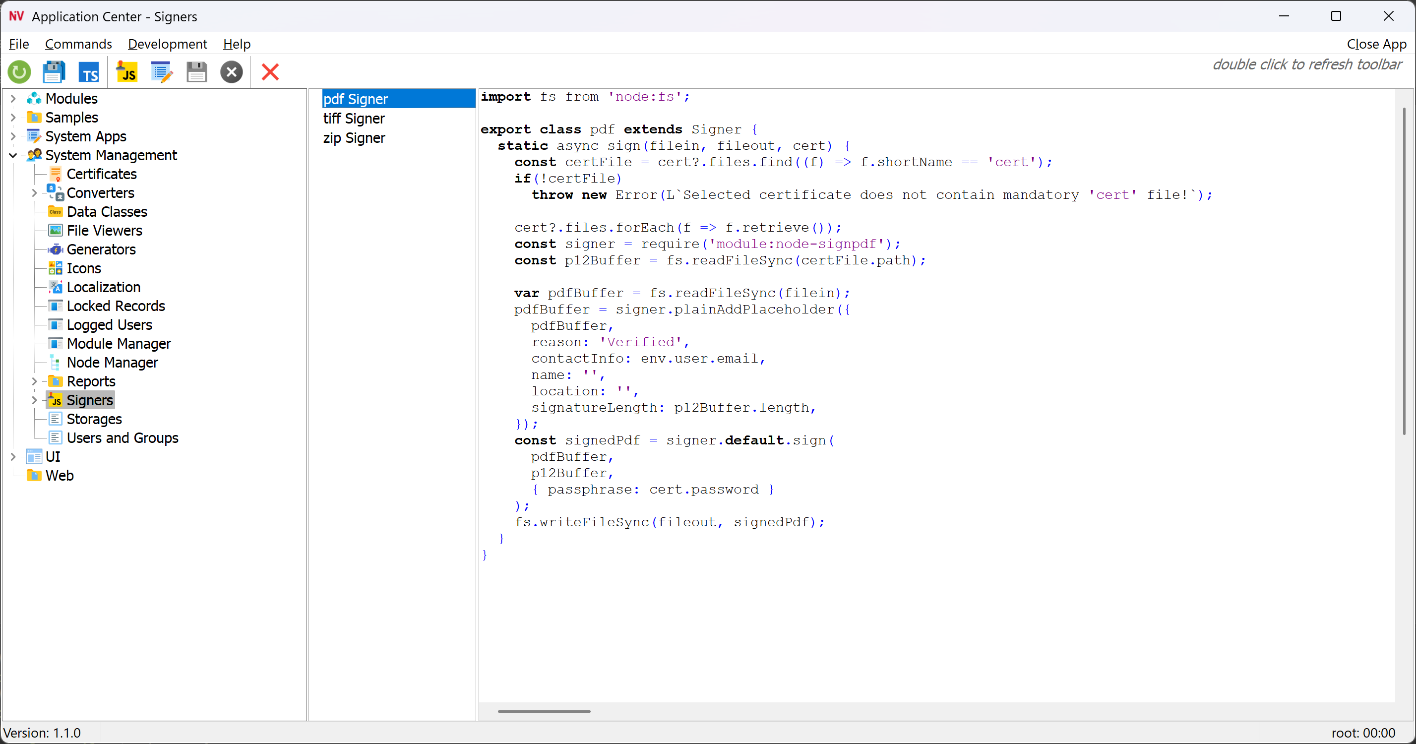

To digitaly sign a document you must define a signer first.
In the picture below we have an example how to define a signer for .pdf file format. Signing is implemented using node-signpdf library from www.npmjs.com repository (see how to install module from NPM in Module Manager).
signers

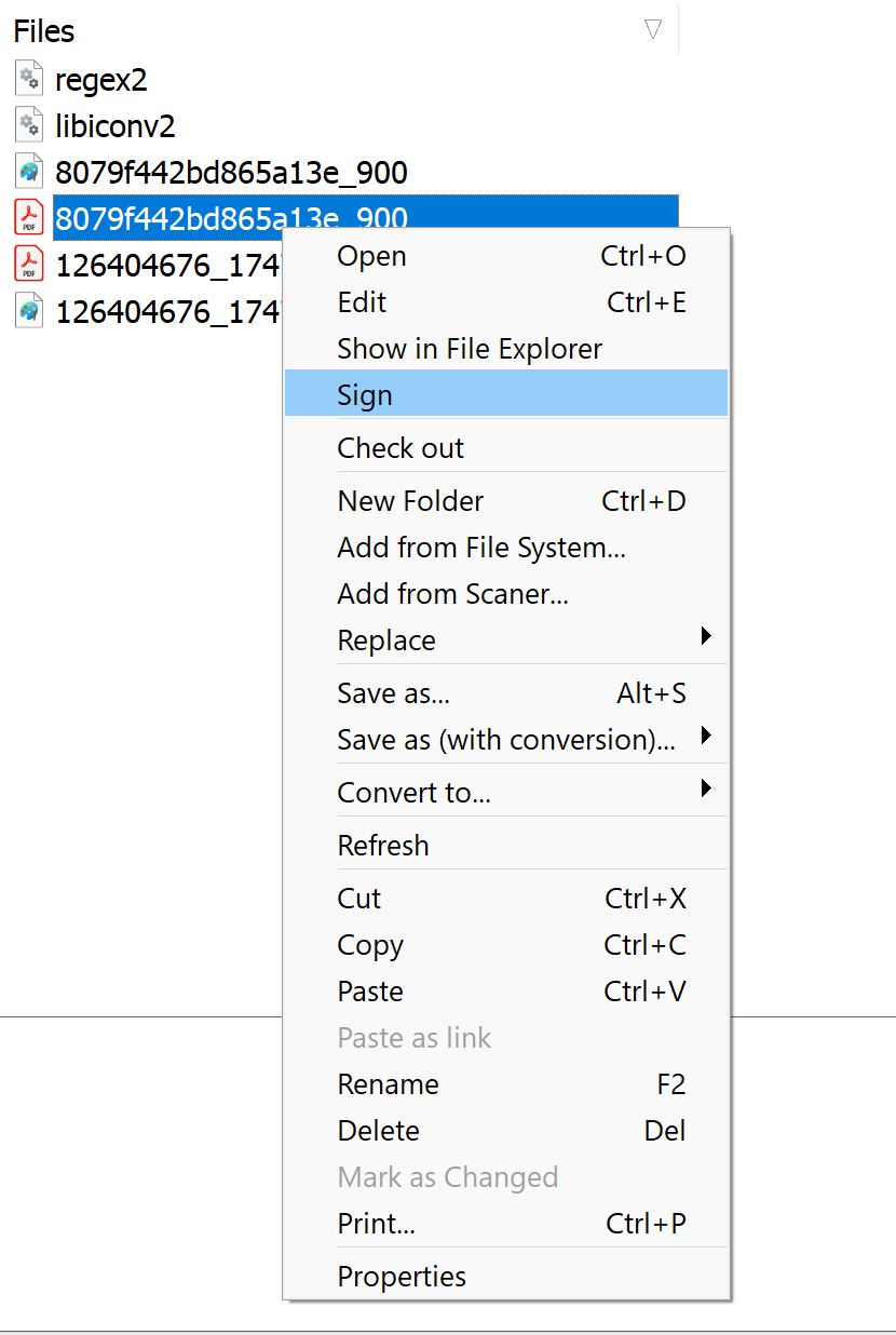

After defining a signer for a certain file type, you will get Sign command in the context menu of FilesView control (see image below).
signers.sign
