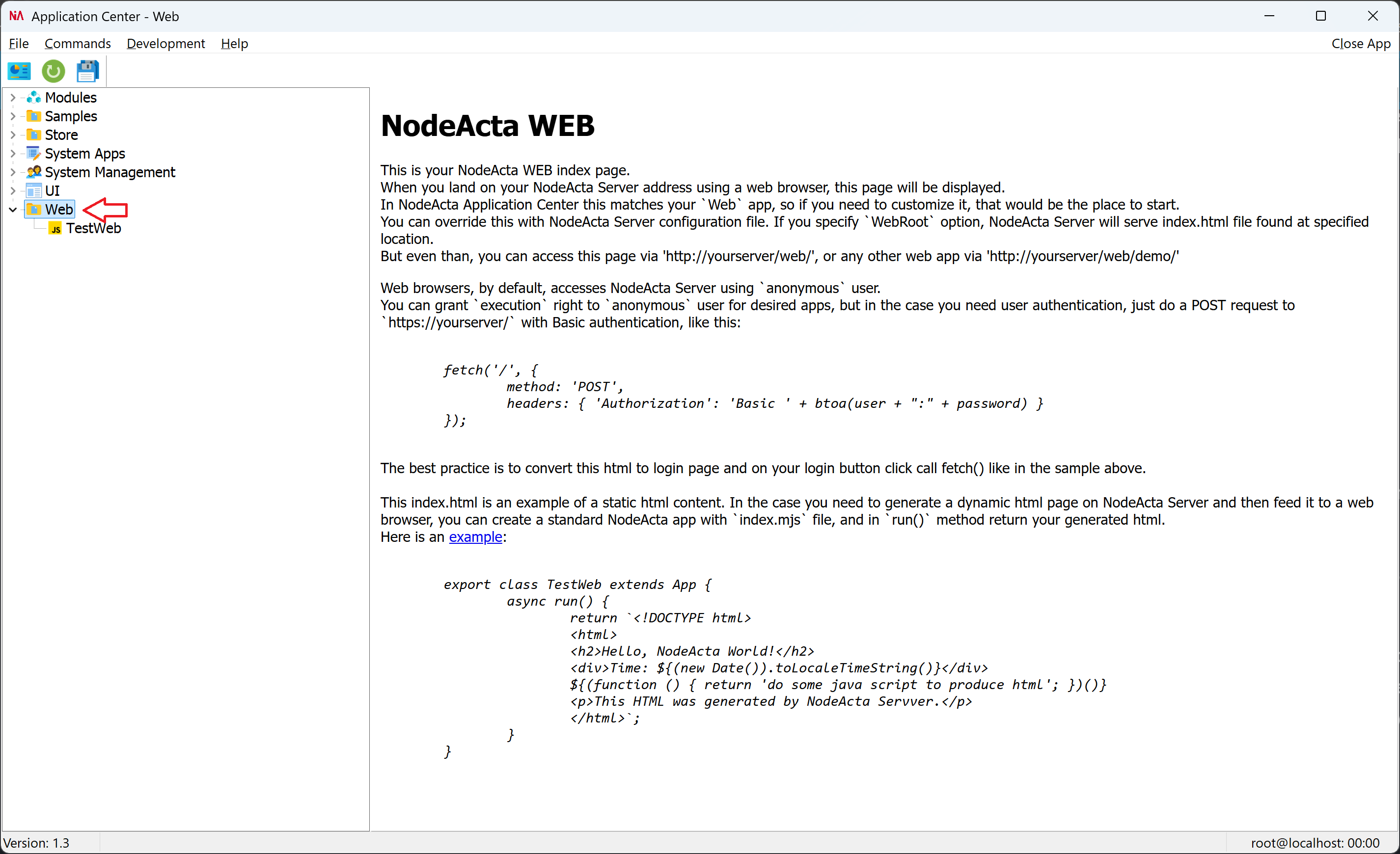

WebApps serve as entry points to your NodeActa system through a web browser. This is especially useful if you don’t have access to a PC with NodeActa Application Center installed, or if you are limited to using a smartphone or tablet. WebApps make your NodeActa system accessible on these devices. The trade-off is that NodeActa UI components are not available in this mode, so you will need to rely on standard web UI libraries instead. When you access your NodeActa system through a web browser, by specifying your server address or url, it will land on WEB app (marked on the picture below). Any other app can be executed via https://my-nodeacta-server/web/my-web-app-1. Of course, you can group your web apps in containers, so something like this is also possible: https://my-nodeacta-server/web/my-container-1/my-web-app-2.

The list of all available WebApps is displayed in your Application Center under WEB container.
Also, note that all WebApps can be run in Application Center too.
